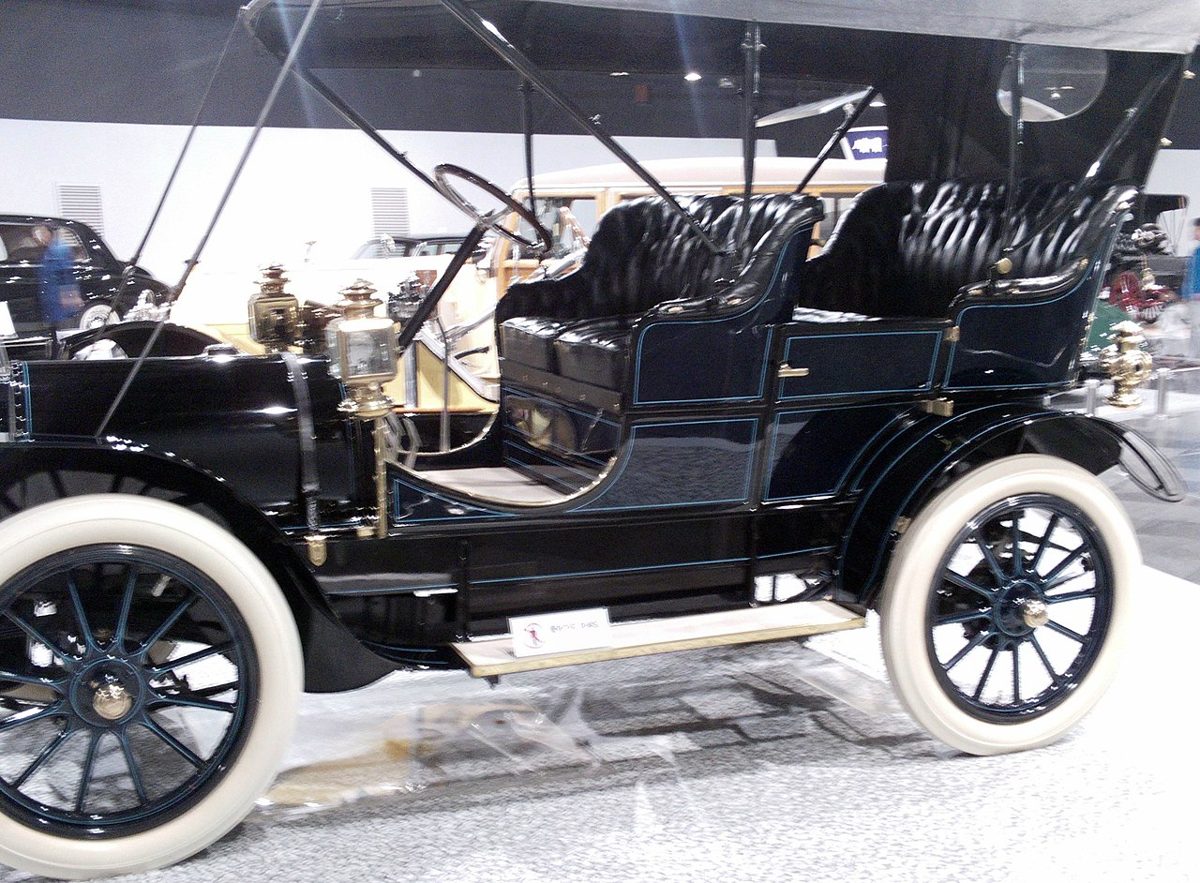

Franklin's aesthetic evolution followed its engineering needs. The earliest models, like the Type A of 1902, featured a transverse engine layout, but the brand soon adopted a longitudinal arrangement that required a hood. Because Franklin cars didn't have a front-mounted radiator, their early hood designs were distinctive. The "barrel hood" models of 1905 to 1910 featured a circular air intake at the front, emphasizing the unique nature of the air-cooled engine within. These cars were instantly recognizable on the road, signaling the owner's commitment to modern, scientific motoring.
In 1916, Franklin introduced the Series 9, which featured the iconic "shovel-nose" hood. This design was not just a stylistic choice but an aerodynamic one, designed to help guide air into the cooling fan. The Series 9 was a massive success, accounting for roughly a third of all Franklins ever produced. It solidified the brand's reputation for reliability and efficiency. By this time, Franklin had also pioneered several other features that would later become industry standards, including automatic spark advance and recirculating pressure-feed oiling systems, further cementimg its place as a technical leader in the American market.

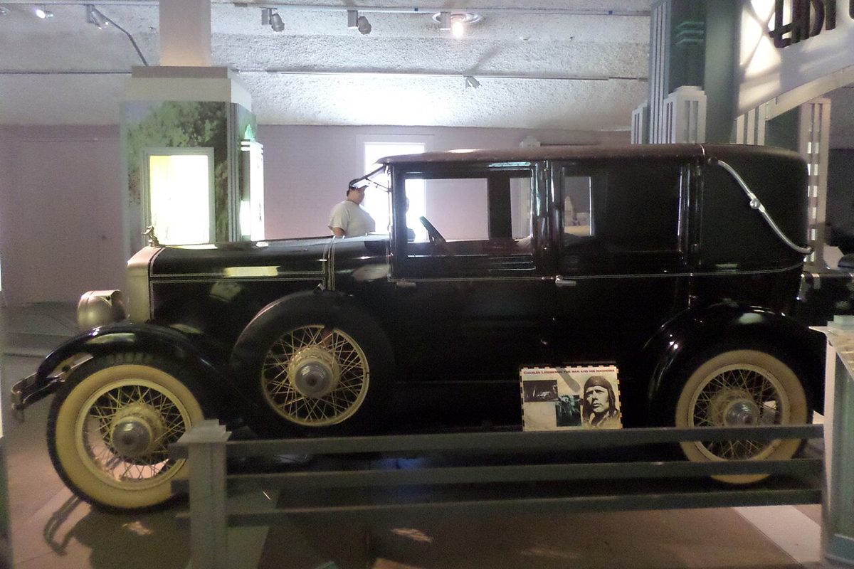

Perhaps the most famous chapter in Franklin's history began in 1927, following Charles Lindbergh's historic transatlantic flight. Lindbergh, a fan of air-cooled engines (his Spirit of St. Louis was powered by an air-cooled Wright Whirlwind), became a vocal supporter of the Franklin brand. He eventually owned several Franklins, and his endorsement was a marketing goldmine. In response, Franklin introduced the "Airman" series, leaning heavily into its aviation pedigree. The Airman models were marketed as being built on "aircraft principles," emphasizing their lightweight construction and air-cooled reliability.
The Airman series represented the pinnacle of Franklin's six-cylinder development. These cars featured advanced sidedraft cooling systems that allowed the engines to produce significantly more power while remaining cool even in the harshest conditions. Styling was further refined by Raymond Dietrich, one of the era's most celebrated coachbuilders. The resulting vehicles were among the most prestigious and technically advanced cars on American roads, favored by engineers, doctors, and professionals who valued the brand's unique blend of performance and sophisticated engineering. For air-cooled enthusiasts today, the Airman series remains a high-water mark for the brand.

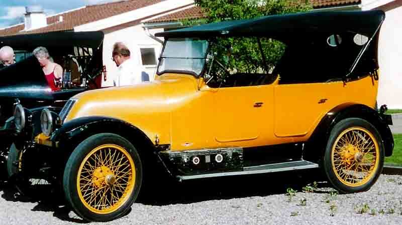

- IMG1: 1906 Franklin Type H. Photo by Unknown author. Licence: Public Domain. Source

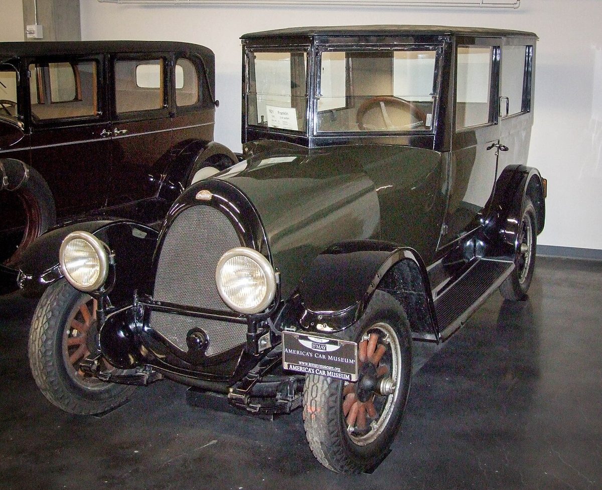

- IMG2: 1907 Franklin Model D roadster. Photo by Harris & Ewing. Licence: Public Domain. Source

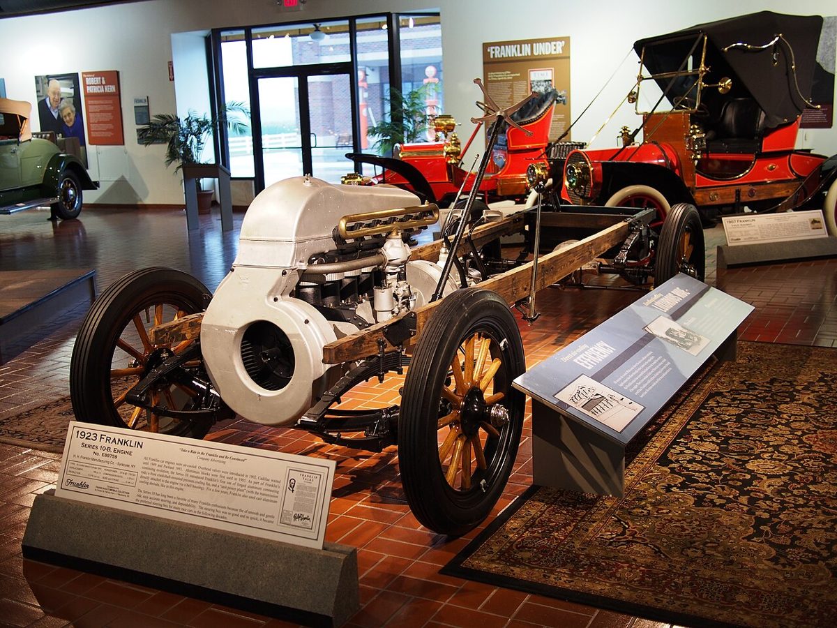

- IMG3: 1910 Franklin Model G Touring. Photo by Katherine Tompkins. Licence: CC BY 2.0. Source

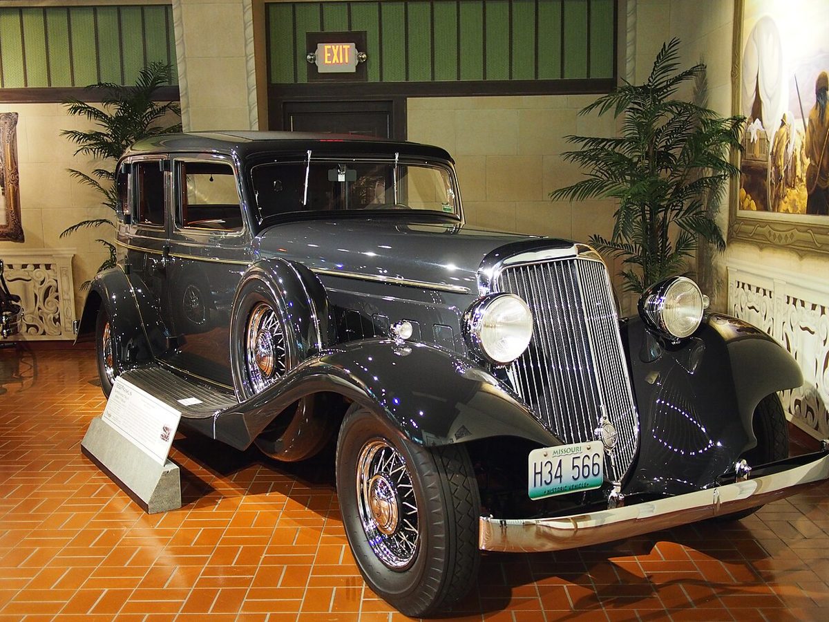

- IMG6: 1923 Franklin Series 10-B. Photo by F. D. Richards. Licence: CC BY-SA 2.0. Source
