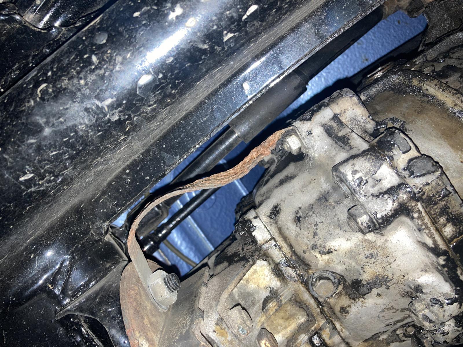

Regarding the (already solved) ground issue...
Did you check the transmission to chassis ground strap too?

i haven't check the trans ground. i know it's in there and connected. but no idea how grounded it actually is. when i took the tans out to replace the mounts 20 years ago i cleaned it up and reinstalled it. can't be any worse than it was when i swapped the mounts.
