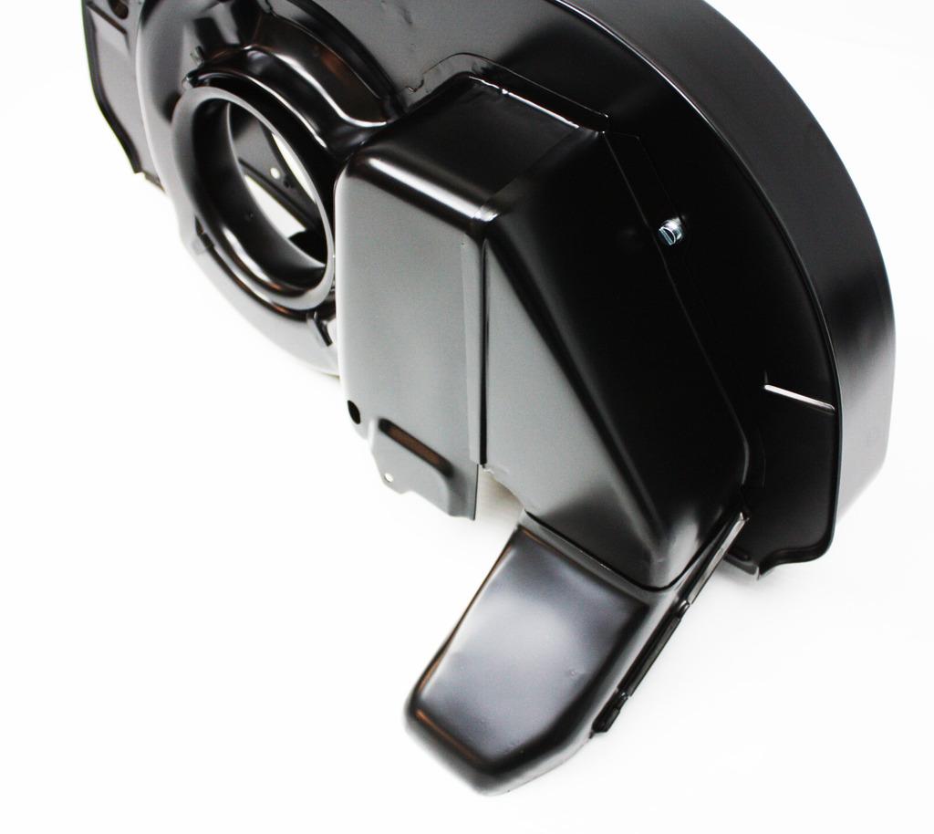

aftermarket tinwork sucks. you have to make it fit. violence, tinsnips and a file are required
edit.
well i got this far. can't find my fuel pump, fuel pump rod, fuel pump mount spacer thing, intake manifold ends. but i did get the tin work fitting pretty decent. no gaps, should work like its suppose to

Posts: 1336
Re: the never ending project. 71 super build
Don't forget the little clip in tins that sit underneath the cylinders. I used to forget installing those all the time.

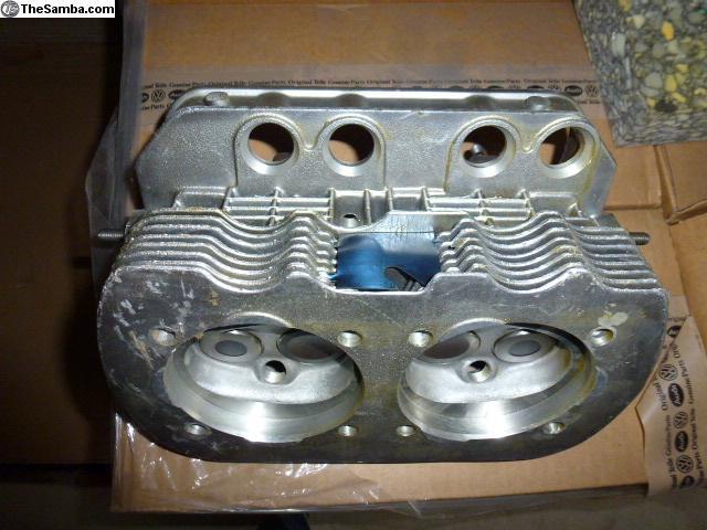

Posts: 1358
schwim wrote: November 1st, 2022, 10:53 amDon't forget the little clip in tins that sit underneath the cylinders.
He has got a long block so SCAT should have installed them.
We call them "Idiotenbleche" over here by the way.
But there are two more "idiot tins" and IMHO there's a good chance they're missing at the (aftermarket) heads...
Randy, good luck with your (epic) quest for missing engine components.

Posts: 1358
Super_Randy wrote: November 6th, 2022, 5:01 pm... i like the clean look of not having the coil mounted on the shroud) so im looing for an option that will work with the stock fuel pump.
also trying to figure out which distributor drive gear to use. iv got 2 in used but equally good condition, but one has a ridge up top and the other is smooth, not sure it really matters but anyone got an opinion or info on the matter?...
If the fan shroud has the dog house putting the coil on that slanted air baffle may be an option. But I have no idea if that tin is firm enough...
As for the distributor drive gear I have no clue. Have seen both versions but don't know which version is stock.
May be both but different years? IDK and can't remember the version that came with my then untouched stock '71 engine.
