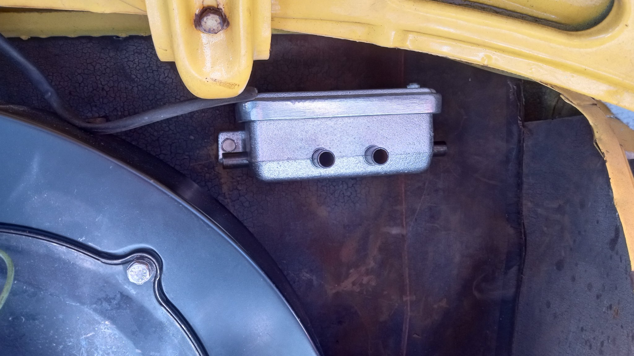

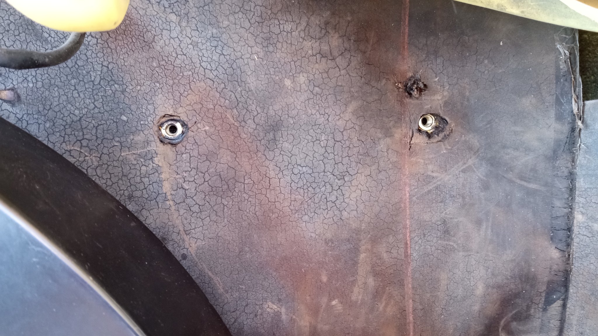

the good news. i did a thing. i bought a riv-nut/nutsert tool and got the breather box mounted.
